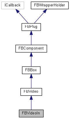

| | FBVideoIn (HIObject pObject=NULL) |
| | Constructor. More...
| virtual bool | LiveSetCompressor (int pCompressorIndex) |
| | Set the current compressor to be used when recording. More...
| virtual int | LiveGetCompressor () |
| | Get the current compressor index. More...
| virtual int | LiveGetCompressorCount () |
| | Get the compressor count. More...
| virtual const char * | LiveGetCompressorName (int pCompressorIndex) |
| | Get the compressor name at a particular index. More...
| virtual void | LiveSetResolutionFR (int pIndex) |
| | Set the current resolution and frame rate for the device. More...
| virtual int | LiveGetResolutionFR () |
| | Get the current resolution and frame rate index. More...
| virtual int | LiveGetResolutionFRCount () |
| | Get the number of resolution and frame rate available for the device. More...
| virtual const char * | LiveGetResolutionFRName (int pIndex) |
| | Get the resolution and frame rate string description at the specified index. More...
| virtual FBVideoLiveType | LiveGetType () |
| | Get the type of the video input device. More...
| | FBVideo (const char *pName, HIObject pObject=NULL) |
| | FBBox (const char *pName, HIObject pObject=NULL) |
| virtual FBAnimationNode * | AnimationNodeInCreate (kReference pUserId, const char *pName, const char *pDataType, bool pIsPublic=false, double *pMin=NULL, double *pMax=NULL, bool pUserData=false) |
| | Creation of IN/OUT Animation Nodes. More...
virtual FBAnimationNode * | AnimationNodeOutCreate (kReference pUserId, const char *pName, const char *pDataType, bool pIsPublic=false, double *pMin=NULL, double *pMax=NULL, bool pUserData=false) |
| virtual bool | EvaluateAnimationNodes (FBEvaluateInfo *pEvaluateInfo) |
| | Evaluation of non TRS nodes that needs to be evaluated. More...
| virtual bool | AnimationNodeNotify (FBAnimationNode *pAnimationNode, FBEvaluateInfo *pEvaluateInfo) |
| | Notification function for animation thread. More...
| virtual bool | ResolveCandidate (FBAnimationNode *pAnimationNode, FBEvaluateInfo *pEvaluateInfo) |
| | Function is call when candidate needs to be resolved (like global to local). More...
| virtual ECandidateAction | SetGlobalCandidate (FBAnimationNode *pAnimationNode, double *pData, FBEvaluateInfo *pEvaluateInfo) |
| | Function is call when a global candidate is set on an animation node. More...
| virtual ECandidateAction | SetStdCandidate (FBAnimationNode *pAnimationNode, double *pData, FBEvaluateInfo *pEvaluateInfo) |
| | Function is call when a non-global candidate is set on an animation node. More...
| virtual bool | FbxStore (FBFbxObject *pFbxObject, kFbxObjectStore pStoreWhat) |
| | Storage/Retrieval of information into the FBX file format. More...
virtual bool | FbxRetrieve (FBFbxObject *pFbxObject, kFbxObjectStore pStoreWhat) |
| virtual bool | AnimationNodeDestroy (FBAnimationNode *pAnimationNode) |
| | Destroy an animation node. More...
| virtual bool | AnimationNodeIsUserData (FBAnimationNode *pAnimationNode) |
| | Is the animation node user data? More...
| virtual void | AnimationNodesOutDisableIfNotWritten (FBEvaluateInfo *pEvaluateInfo) |
| | This call will disable all out animation nodes from being pull by system (animation thread) for given pEvaluateInfo. More...
| virtual FBAnimationNode * | AnimationNodeInGet () |
| | Get the (IN/OUT) animation node for this box. More...
virtual FBAnimationNode * | AnimationNodeOutGet () |
| virtual const char * | FbxGetObjectType () |
| | Returns the class type inherited by the class of an object, for example: 'Box', 'Constraint', 'TimelineXTrack'. More...
| virtual const char * | FbxGetObjectSubType () |
| | Returns the class sub type inherited by the class of an object, for example: 'Relations', 'Parent-Child', 'Number to Vector', 'Shot'. More...
| IObject_Declare (override) |
| virtual int | GetOutConnectorCount () const |
| | Get the number of animation node outputs for this box. More...
| virtual int | GetInConnectorCount () const |
| | Get the number of animation node inputs for this box. More...
| virtual FBAnimationNode * | GetOutConnector (int pIndex) const |
| | Get the animation node output associated with the given index. More...
| virtual FBAnimationNode * | GetInConnector (int pIndex) const |
| | Get the animation node input associated with the given index. More...
| | FBComponent (HIObject pObject) |
| virtual | ~FBComponent () |
| | Destructor. More...
| virtual bool | FBCreate () |
| | Open Reality Creation function. More...
| virtual void | FBDestroy () |
| | Open Reality destruction function. More...
| virtual void | FBDelete () override |
| | Open Reality deletion function. More...
| virtual bool | SetHIObject (HIObject pObject, bool pSDKComponent) override |
| | Assign component to an internal pointer. More...
| virtual int | PropertyAdd (FBProperty *pProperty) |
| | Add a property to the component's property manager. More...
| bool | PropertyAddReferenceProperty (FBProperty *pReferenceProperty) |
| | Add a reference property to the component's property manager. More...
| void | PropertyRemove (FBProperty *pProperty) |
| | Remove a Property from the component's Property manager. More...
| void | PropertyGetModifiedList (FBArrayTemplate< FBProperty * > &pPropList, FBPlugModificationFlag pModificationFlags) |
| | Get list of properties which have been modified since last loading. More...
| FBProperty * | PropertyCreate (const char *pName, FBPropertyType pType, const char *pDataType, bool pAnimatable, bool pIsUser=false, FBProperty *pReferenceSource=NULL) |
| | Create user or dynamic property. More...
| FBObjectFlag | GetObjectFlags () |
| | Get all Object Flags (concatenated). More...
| void | SetObjectFlags (FBObjectFlag pFlags) |
| | SetObjectFlags. More...
| bool | HasObjectFlags (FBObjectFlag pFlags) |
| | Check whether a specific object flag is enabled. More...
| void | EnableObjectFlags (FBObjectFlag pFlags) |
| | Enable a specific Object Flags. More...
| void | DisableObjectFlags (FBObjectFlag pFlags) |
| | Disable a specific Object Flags. More...
| void | SetObjectStatus (FBObjectStatus pStatus, bool pValue) |
| | Enable/Disable a specific Object Status. More...
| bool | GetObjectStatus (FBObjectStatus pStatus) |
| | Check to see if an object status is enabled. More...
| bool | ProcessNamespaceHierarchy (FBNamespaceAction pNamespaceAction, const char *pNamespaceName, const char *pReplaceTo=NULL, bool pAddRight=true) |
| | ProcessNamespaceHierarchy. More...
| bool | ProcessObjectNamespace (FBNamespaceAction pNamespaceAction, const char *pNamespaceName, const char *pReplaceTo=NULL, bool pAddRight=true) |
| | ProcessObjectNamespace. More...
| virtual const char * | ClassName () override |
| | Get the class name. More...
| virtual bool | UseCustomPropertyViewSet () const |
| | Use the custom property viewSet or not. More...
| const char * | GetFullName (void) |
| | Get the full name. More...
| void | SetOwnerNamespace (FBNamespace *pOwnerNSObj) |
| | Set the owner Namespace object. More...
| FBNamespace * | GetOwnerNamespace (void) |
| | Get the owner Namespace object. More...
| FBFileReference * | GetOwnerFileReference (void) |
| | Get the owner FileReference object. More...
| void | HardSelect () |
| | HardSelect. More...
| virtual bool | Is (int pTypeId) override |
| | Returns true if object is of type TypeId. More...
| virtual int | GetTypeId () override |
| | GetTypeId( int pTypeId ) More...
| FBScriptWrapper * | GetWrapper () |
| | Return the wrapper interface of this FBObject. More...
void | AddWrapper (FBScriptWrapper *) |
void | RemoveWrapper (FBScriptWrapper *) |
| enum | ECandidateAction {
eCandidateAccept
eCandidateIntercept
eCandidateInterceptAfterEvaluation
| | Resolving action for candidates. More...
| static int | GetInternalClassId () |
static void | FBComponentSetName (FBComponent *pObject, const char *pName) |
static const char * | FBComponentGetName (FBComponent *pObject) |
static void | FBComponentSetLongName (FBComponent *pObject, const char *pName) |
static const char * | FBComponentGetLongName (FBComponent *pObject) |
| static int | TypeInfo |
| | Contains the Type information of the object. More...
| bool | IsSDKComponent () |
| | Return whether or not item is an SDK component. More...
| bool | ConnectSrc (FBPlug *pSrc, FBConnectionType pConnectionType=kFBConnectionTypeNone) |
| | Add a source connection. More...
| bool | ConnectDst (FBPlug *pDst, FBConnectionType pConnectionType=kFBConnectionTypeNone) |
| | Add a destination connection. More...
| bool | ConnectSrcAt (int pDst_SrcIndex, FBPlug *pSrc, FBConnectionType pConnectionType=kFBConnectionTypeNone) |
| bool | ConnectDstAt (int pSrc_DstIndex, FBPlug *pDst, FBConnectionType pConnectionType=kFBConnectionTypeNone) |
| bool | DisconnectDst (FBPlug *pDst) |
| | Remove a destination connection. More...
| bool | DisconnectSrc (FBPlug *pSrc) |
| | Remove a source connection. More...
| void | DisconnectAllSrc () |
| | Remove all source connections. More...
| void | DisconnectAllDst () |
| | Remove all destination connections. More...
| bool | DisconnectDstAt (int pIndex) |
| | Remove a destination connection at a specified index. More...
| bool | DisconnectSrcAt (int pIndex) |
| | Remove a source connection at a specified index. More...
| bool | ReplaceDstAt (int pIndex, FBPlug *pDst) |
| | Replace a destination connection at a specified index. More...
| bool | ReplaceSrcAt (int pIndex, FBPlug *pSrc) |
| | Replace a source connection at a specified index. More...
| bool | SwapSrc (int pIndexA, int pIndexB) |
| | Swap source connection at index A with source connection at index B. More...
| bool | MoveSrcAt (int pIndex, int pAtIndex) |
| | Move source connection at pIndex to pAtIndex. More...
| bool | MoveSrcAt (FBPlug *pSrc, FBPlug *pAtSrc) |
| | Move source connection pSrc to the position of pAtSrc. More...
| int | GetSrcCount () |
| | Get source connection count. More...
| FBPlug * | GetSrc (int pIndex) |
| | Get a source connection's plug at specified index. More...
| FBConnectionType | GetSrcType (int pIndex) |
| | Get a source connection's type at specified index. More...
| int | GetDstCount () |
| | Get destination connection count. More...
| FBPlug * | GetDst (int pIndex) |
| | Get a destination connection's plug at specified index. More...
| FBConnectionType | GetDstType (int pIndex) |
| | Get a destination connection's type at specified index. More...
| bool | BeginChange () |
| | Begins a change on multiple plugs. More...
| void | EndChange () |
| | Ends a change on multiple plugs. More...
| void | SetSelfModified (FBPlugModificationFlag pFlag, bool pBool) |
| | Set the plug's self modification flag. More...
| bool | GetSelfModified (FBPlugModificationFlag pFlag) |
| | Tell if the plug's self has changed. More...
| void | SetContentModified (FBPlugModificationFlag pFlag, bool pBool) |
| | Set the plug's owned property/object's modification flag. More...

Basic video input class, supporting webcam and DV device.
Definition at line 362 of file fbvideo.h.
