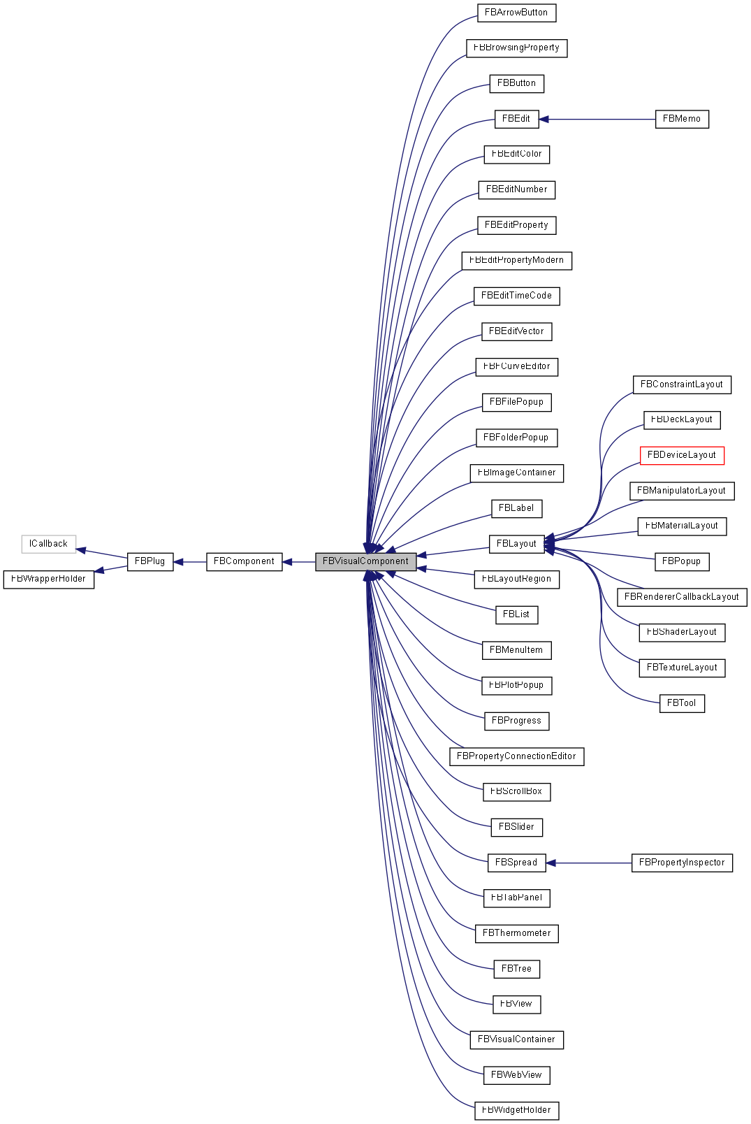

Visual Component base class. More...
#include <fbcontrols.h>
All of the user interface elements available in the SDK derive from this class.
Definition at line 312 of file fbcontrols.h.
