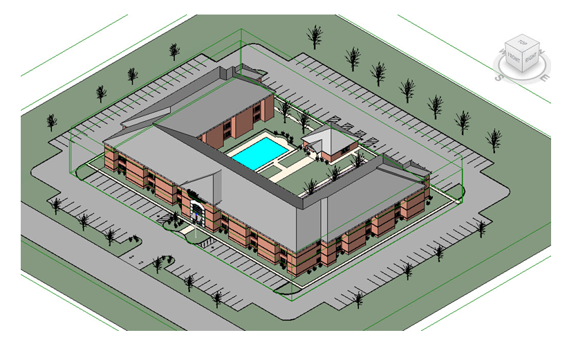

For example, this model contains a large number of site and architectural details:
While technically possible to include this level of detail in the Autodesk® CFD model, the model size would be prohibitively large, and these features would not significantly affect the overall results. Before transferring such a model into Autodesk® CFD, it is a good idea to simplify the geometry and remove extraneous details. The analysis-ready version of this model looks like this:

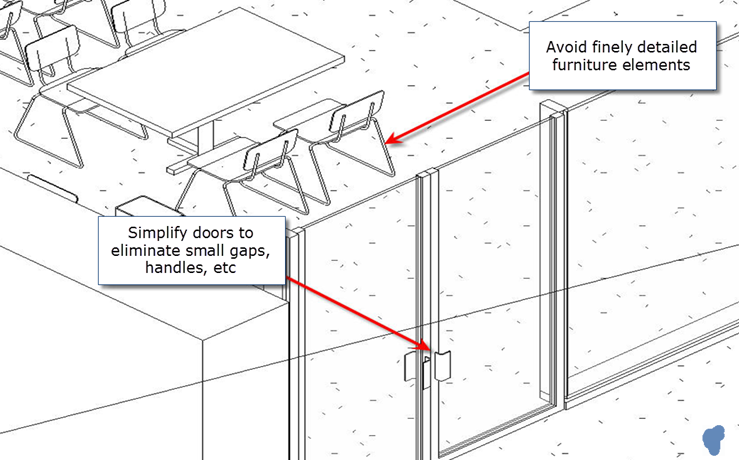

Many small details that are essential to the design model are not necessary for the Autodesk® CFD simulation. Prior to transferring the model into Autodesk® CFD, use the following techniques to reduce the geometric complexity in the Revit model:

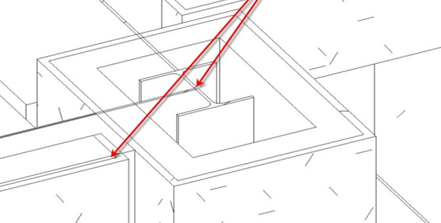

Avoid small interferences and gaps between structural elements (such columns and beams) and neighboring geometry.
In the image, small interferences exist between structure and cladding around the outside of the column and beams:

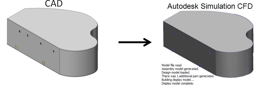

Method 1: Ensure the volume is "air tight"
Autodesk® CFD automatically replaces all completely enclosed cavities with internal volumes when the model is transferred from CAD.

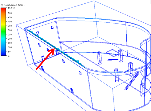

Create a Test Mesh
Long, thin gaps are usually meshed with long, skinny elements. The areas in the model with the highest values of Nodal Aspect ratio are likely where the gaps are. This procedure is summarized:
After finding the gaps, eliminate them by aligning the mismatching features in the CAD model.
