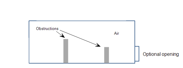

If the intent is to simulate the natural ventilation within the enclosure, model the structure, relevant obstructions, and internal air.
If the structure has openings, a good practice is to extend the openings in the CAD model to ensure enough space between the boundary conditions and the internal flow.

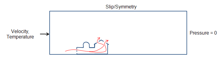

If the structure is vented, and wind loading is a consideration in addition to the natural ventilation within the structure, create a volume that surrounds the structure:
