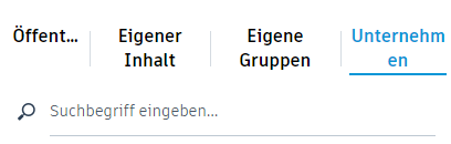

Specify the data to bring into Civil 3D by browsing available datasets for the selected area of interest using the Public, My Content, My Groups, and Organization filters.
