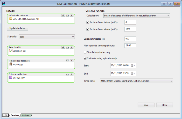

PDM Calibration Dialog Settings Tab
The dialog is used to:
The Settings tab
The items specified on the Settings tab control how the calibration will be performed.
The table below describes the options available on the dialog:
Item
Description
InfoWorks network
The name of the network that contains the PDM Descriptor object(s) that are to be calibrated.
The initial values for the PDM parameters come from a committed version of this network, and calibrated values will be written back to the latest version of the network.
The network can be selected using one of the following methods:
  • Drag and drop a network from the Explorer Window tree. The most recently committed version of the network will be selected.
  • Click the Browse button, select a network from the displayed tree and click OK. The most recently committed version of the selected network will be used.
  • Click the Select version button to display the Select Commit dialog. Click on an entry in the dialog and click OK to select the required version of the network.
Update to latest Updates the selected InfoWorks network to the most recent committed version.
Scenario The scenario from which and to which the PDM decriptor parameters will be taken/written. This can be selected from the dropdown list.
Selection list
The selection list which must contain one or more subcatchments whose PDM Descriptors are to be used in the calibration operation.
  • Drag and drop a selection list from the Explorer Window tree.
  • Click the Browse button, select a list from the displayed tree and click OK.
  • Click the Current button to create a selection list that consists of the network objects currently selected on the GeoPlan.
Time series database
The TSDB that supplies the observed rainfall, and if required, potential evaporation, temperature, and flow (for comparison).
  • Drag and drop a TSDB from the Explorer Window tree.
  • Click the Browse button, select the TSDB from the displayed tree and click OK.
The latest version of the TSDB will always be used.
Episode collection
The episode collection (optional) that contains the flood or rainfall events which are to be included in the calibration.
  • Drag and drop an episode collection from the Explorer Window tree.
  • Click the Browse button, select the episode collection from the displayed tree and click OK.
The calibration period can be divided into episodes and intervening times.
Episodes can be run with a shorter timestep, and the intervening periods can be included or omitted from the calibration. If daily observations are being used between episodes, then it is advisable for the episodes to start and end at the same time of day as the daily observation is taken.
If no episode collection is specified, then the entire period will be simulated and used in the objective function calculation.
Calculation The method for calculating the objective function can be selected from a dropdown list. The default, and recommended method, is Mean of squares of differences.
Exclude flows below
If checked, this field indicates that a low flow is to be ignored when calculating the objective function.
A threshold for the low flow is specified in the adjacent field.
Exclude flows above
If checked, this field indicates that a high flow is to be ignored when calculating the objective function.
A threshold for the high flow is specified in the adjacent field.
Episode timestep
The timestep, in seconds, that will be used for simulation and calculation of the objective function during episodes.
This normally matches the timestep of the observed data during those periods, but if it does not, then the observed data will be interpolated or sampled accordingly.
This box is only enabled when a Episode collection has been specified.
Non-episode timestep
The timestep, in hours, for the rest of the simulation. This is usually 24 hours (default).
Simulate episodes only
If checked, the simulation is restarted at the beginning of each episode.
Calibrate using episodes only
If checked then the objective function will be calculated using just the episodes. If not selected, then the whole period will be used, with every timestep being given equal weight in the objective function calculation.
Start
The start and end dates and time for the simulation. The start time is always 00:00 hours, and the end time is always 23:59.
Any episodes that lie outside this time-frame will be ignored. Any episodes that lie partially outside this time-frame will be partially simulated.
If the entire time-frame is covered by episodes, then there will be no non-episode simulations. If there are no episodes in the time-frame (or none are specified at all), then the non-episode timestep will be used throughout.
End
Time zone The time zone for the simulation, which is used for coordinating the episode and start/end times with the timestamps of the observed data. The time zone can be selected from the dropdown list.
Save Saves the current settings to the PDM calibration object.
Close Closes the window. If any changes have been made to the Settings tab, a message will be displayed informing you that the settings have changed and asks if you want to save the changes.

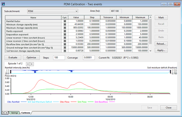

The Calibrate tab
This tab is used to perform the calibration operation on a PDM descriptor.
The table below describes the items available on the dialog:
Item
Description
Subcatchment
A dropdown list of all subcatchments contained in the Selection list specified in the Settings tab. The area and PDM descriptor from the selected subcatchment will be used in the calibration operation.
Note: Subcatchments may share the same PDM descriptor; calibrating one subcatchment will change the parameters for all subcatchments that use the same descriptor, but only the selected subcatchment’s area and TVD connectors will be used in the calibration process.
Area A read-only field which contains the size of the subcatchment as defined in the network. This value is used when calculating the runoff.
Parameter grid
This grid lists all the parameters for the PDM descriptor associated with the selected Subcatchment
Parameter values can be changed by typing or pasting in a new value.
Name The name for the PDM parameter.
Opt. A cross (x) in the box indicates that this PDM parameter can be adjusted as part of the optimisation process. Parameter without a x next to them will not be adjusted as a result of optimisation.
Value The current value of the parameter. This will be used as the starting point of the next optimisation cycle, and is also the value used to evaluate the fit if the Evaluate button is clicked.
Step The initial step size used to adjust the parameter in the optimisation process.
Tolerance The convergence tolerance for the parameter in the optimisation process.
Minimum The minimum value that the parameter can have during optimisation.
Maximum The maximum value that the parameter can have during optimisation.
Evaluate Calculates the objective function (i.e. the fit) according to the method specified in the Calculation field in the Settings tab, and the coefficient of determination (R2) for the current parameter values, and updates the graph.
Optimise Performs a cycle of optimisation, starting from the current parameter values (which then calculates the fit and R2), and updates the grid and graph.
Steps The maximum number of iterations to be used in a cycle of optimisation.
Converge A cycle of optimisation will finish when the objective functions for all candidate parameter sets (i.e. all sets of changed parameters plus the original set of parameters) differ by no more than the Converge value.
Current fit A read-only field which displays the most recently calculated value of the objective function, using the Calculation method selected on the Settings tab.
R**2 A read-only field which displays the most recently calculated value of the coefficient of determination or goodness-of-fit, R2.
Mark
Saves the current set of parameters to a temporary scratch-pad.
The Save Parameters Values dialog is displayed into which you can specify a name to identify this set of parameters.
Recall
Retrieves a set of parameters from the temporary scratch-pad.
The Recall Parameters Values dialog is displayed from which you can select the appropriate set of parameters which have been previously saved using the Mark button.
Undo Undos the most recent cycle of optimisation.
Redo Redos a previously undone cycle of optimisation.
Reload Retrieves the set of parameters from the version of the network selected on the Settings tab.
Apply Saves the current set of parameters to the PDM descriptor, referenced by the subcatchment, in the current version of the network.
Graph The graph shows the observed rainfall and flow, together with the simulated soil moisture deficit, baseflow and runoff flow. The arrows can be used to step between showing the entire period and individual episodes.
Save Saves the current settings to the PDM calibration object. Note that any parameter values temporarily saved to the scratch-pad will not be saved.
Close
Closes the window.
If any changes have been made to the Calibrate tab, a message will be displayed informing you that the settings have changed and asks if you want to save the changes.
