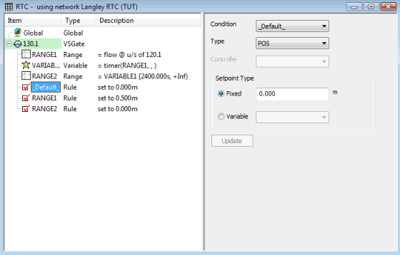

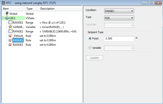

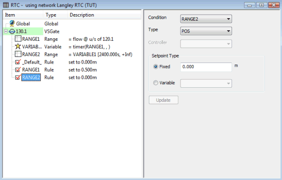

Variable Example 1 - Use of a Variable as a Timer
The following example models controlling the status of a sluice gate, by applying a time delay in order to close the sluice gate 40 minutes after it has been opened.
In this example, a variable is used as a timer. The timer starts when the sluice gate is opened. Once the timer has reached 40 minutes, the gate is closed.
The example is defined by adding components to a sluice gate regulator in the RTC Window Editor.
Component
Parameters
Effect

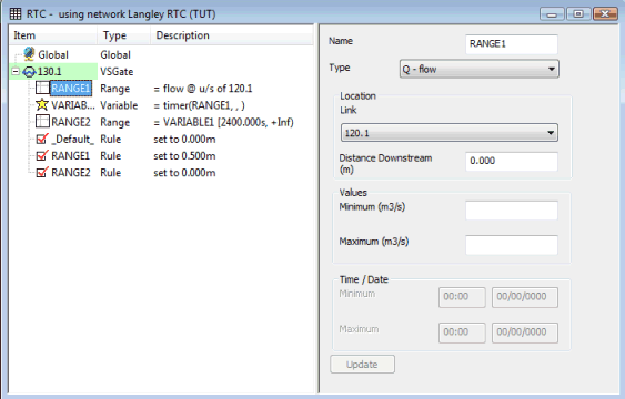

RANGE 1
Range type: Q - flow
Location link: 120.1
Distance Downstream: 0m
Minimum:
Maximum:
TRUE if flow in conduit 120.1 is between +/- infinity
VARIABLE 1
Measurement: Time
Operator: Timer
Start: RANGE 1
Start Timer when RANGE 1 becomes TRUE

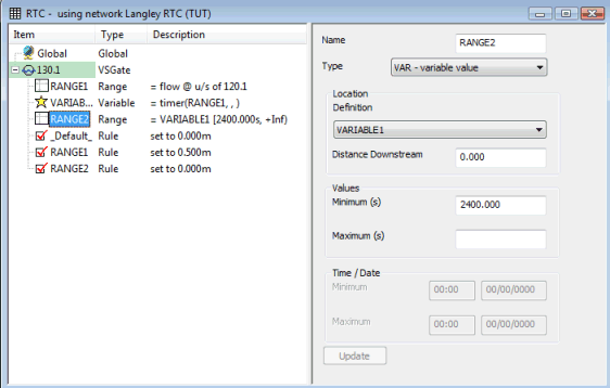

RANGE 2
Range type: Variable
Location definition: VARIABLE 1
Minimum: 2400 s
Maximum:
TRUE if VARIABLE 1 is greater than 2400s
RULE 1
Condition: _default_
Rule type: POS
Setpoint Type: FIXED 0.000 m
DEFAULT status of gate is Closed
RULE 2
Condition: RANGE 1
Rule type: POS
Setpoint Type: FIXED 0.500 m
Set sluice gate to 0.5 m if RANGE 1 is TRUE
RULE 3
Condition: RANGE 2Rule type: POS
Setpoint type: FIXED 0.000 m
Set sluice gate to 0.0 m if RANGE 2 is TRUE
  1. Range 1: Defines Link 120.1 as a control link
  2. Variable 1: Starts Timer when flow in link 120.1 is greater than or equal to 0.01 m3/s
  3. Range 2: Defines the calculated time in Variable 1 as a control with a minimum value of 2400s (40 mins)
  4. Rule 1: Unless subsequent rules are TRUE, sluice gate is closed
  5. Rule 2: Unless subsequent rules are TRUE, sets sluice gate opening to 0.5 m
  6. Rule 3: When the Timer defined in Variable 1 reaches 2400s (40 mins), sluice gate is Closed

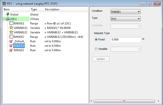

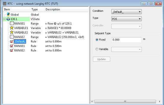

Variable Example 2
The following example models controlling the operation of a sluice gate, by measurement of the total flow through a conduit. When the total flow in the conduit reaches a given volume, the sluice gate will be closed.
In this example, a variable is used to convert the flow measured in the control conduit to a cumulative flow over a timestep. A second variable is used to keep a total of the cumulative flow.
Component
Parameters
Effect

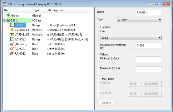

RANGE 1
Minimum:
Maximum:
TRUE if flow is between - / + infinity

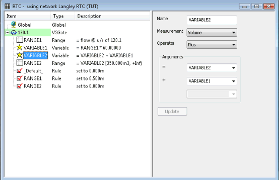

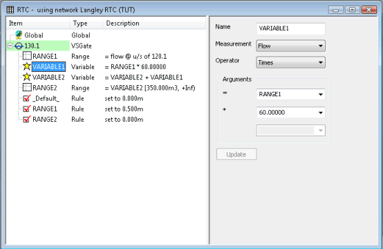

VARIABLE 1
Measurement: Flow
Operator: Times
Argument 1: RANGE 1
Argument 2: Constant = 60
Equals RANGE 1 flow multiplied by 60
VARIABLE 2
Measurement: Volume
Operator: Plus
Argument 1: VARIABLE 2
Argument 2: VARIABLE 1
Equals VARIABLE 1 + VARIABLE 2

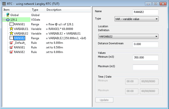

RANGE 2
Location definition: VARIABLE 2
Minimum: 350 m3
Maximum:
TRUE if VARIABLE 2 is greater than or equal to 350 m3
RULE 1
Rule type: POS
DEFAULT status of sluice gate is 0.0 m
RULE 2
Condition: RANGE 1
Rule type: POS

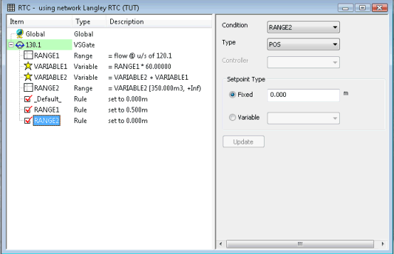

RULE 3
  1. Range 1: Defines Link 120.1 as a control link in which flow is measured
  2. Variable 1: Calculates total flow over timestep
  3. Variable 2: Calculates cumulative flow through Link 120.1
  4. Range 2: Defines Variable 2 as a control with a minimum value of 350 m3
  5. Rule 1: Unless subsequent rules are TRUE, sets sluice gate to 0.0 m
  6. Rule 2: Unless subsequent rules are TRUE, sets sluice gate to 0.5 m
  7. Rule 3: When cumulative flow through Link 120.1 reaches 350 m3, sets sluice gate to 0.0 m
