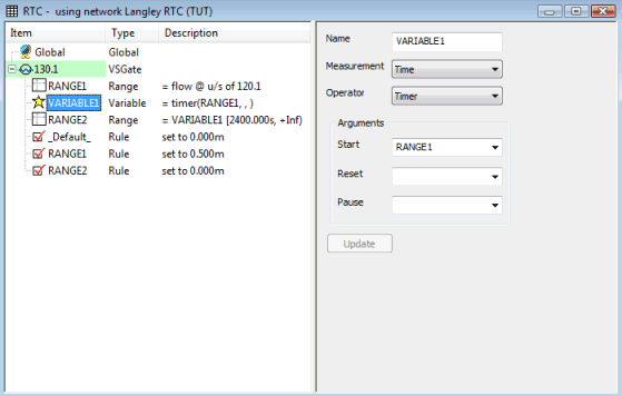

Timer
The Timer operator allows you to set up the variable as a timer. The value of the variable is the number of seconds since it was started (excluding pauses). The operation of the timer is as follows:
Arguments 2 and 3 may be blank.
