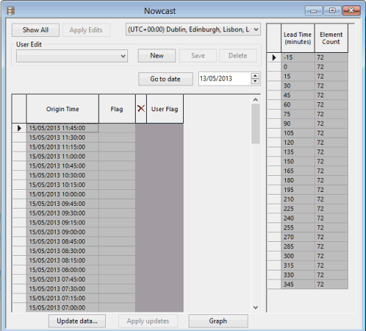

A Spatial Time Series Database (STSDB) database object (Spatial Time Series Database icon) is used for storing spatial time varying data (TVD) that comes from external data sources. It can be used in simulations for InfoWorks and SWMM networks.
TSDB
An example of a configured spatial TSDB
For an in-depth description of the data and options available for this object, see the Time Series Database Grid topic.

To configure a spatial TSDB
  1. Create a new spatial TSDB.
  2. Drag the spatial TSDB object from the Explorer window and drop it onto the GeoPlan or the main window.
    The Spatial time series database configuration dialog is displayed.
  3. Configure the import as appropriate (See the Spatial time series database configuration dialog for more information).
  4. When finished, click OK.
  5. The Time Series Data grid is displayed.

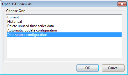

To open the Data Source configuration setting for a spatial TSDB
  1. Right-click a spatial TSDB object in the Explorer Window and select Open As from the context menu.
  2. Select the Data source configuration option from the Open TSDB view as dialog.
  3. Open TSDB view as dialog
  4. Click OK.
  5. The Spatial time series database configuration dialog is displayed.
