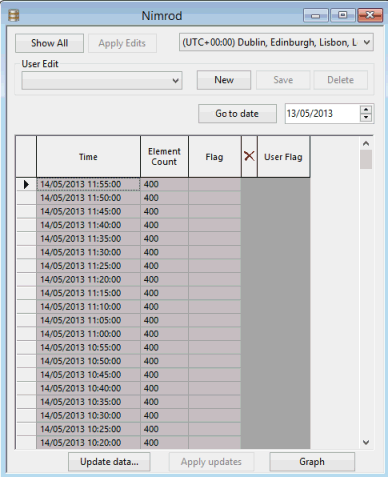

There are four different types of the time series data grid :
Time Series Data Grid
Example of time series database grid (observed data)
Example of spatial time series database grid (forecast)

The Time Series Data grid shows the time series data points for an individual stream. Latest values are displayed at the top.
The layout of the grid depends on the data type (observed or forecast).
The table below summarises the fields and options common to both types:

Time
Data point timestamp.
Element Count
Available for spatial time series databases only.
Displays the number of elements associated with each time.
