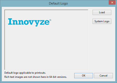

InfoWorks ICM allows the inclusion of a user defined logo in printouts of the following views:
A default logo to be used in the printouts of these views can be set in the InfoWorks ICM via the Default Logo dialog. The logo can be loaded from a Rich Text (.rtf) file, or the InfoWorks ICM default can be used.
To set the default logo
  1. Select Database managementDefault logo from the File menu. This displays the Default Logo dialog.
  2. Select the file containing the logo to be used as a default:
    • Click Load to search for an .rtf file using a Windows Open Dialog.
    • Click System Logo to set the InfoWorks ICM logo as the default.
  3. Click OK to accept changes.
Note: If the database global settings are protected, only database owners will be able to make changes to the Default Logo. (See User Permissions for more information).
