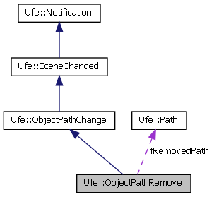

Path removed from object scene notification.
A path remove notification is a path change notification where an existing path is removed from an existing object. Not all runtimes support these semantics. Data model observers must reflect the removal of the path, but the tail component object itself is unchanged. When the last path to an object is removed, an ObjectDelete notification will be sent. Implicitly, all children of the object from which a path was removed have also had a path removed from them; no notification is sent for this.
