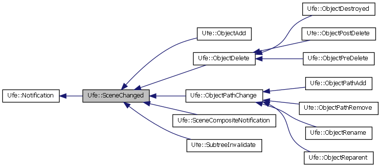

Inheritance diagram for Ufe::SceneChanged:
Collaboration diagram for Ufe::SceneChanged:
