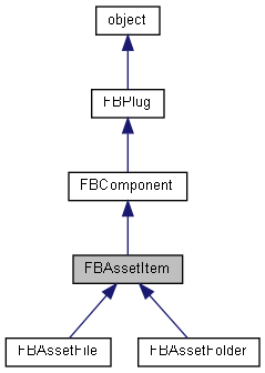

Base class for all managed assets. More...
#include <pyfbsdk_generated.h>
| FBAssetItem | ( | str | pName | ) |
