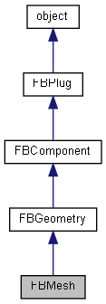

#include <pyfbsdk_generated.h>
Inheritance diagram for FBMesh:
