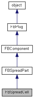

Spreadsheet cell. More...
#include <pyfbsdk_generated.h>

Spreadsheet cell.
| FBSpreadCell | ( | FBSpread | pParent, |
| kReference | pRow, | ||
| int | pCol | ||
Constructor.
| pParent | Parent spreadsheet. |
| pRow | Row to which cell belongs. |
| pCol | Column to which cell belongs. |
