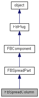

Spreadsheet column. More...
#include <pyfbsdk_generated.h>
Public Member Functions | |
| FBSpreadColumn (FBSpread pParent, int pCol) | |
| Constructor. More... | |
