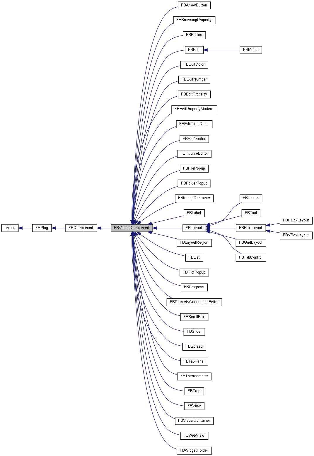

Visual Component base class. More...
#include <pyfbsdk_generated.h>
All of the user interface elements available in the SDK derive from this class.
