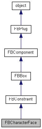

Animates a character face using an actor as input. More...
#include <pyfbsdk.h>
