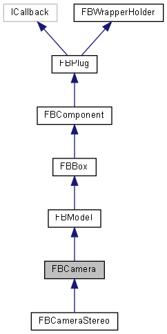

Creates custom cameras and manages system cameras. More...
#include <fbcamera.h>
Public Member Functions | |
| FBCamera (const char *pName, HIObject pObject=NULL) | |
| Constructor. More... | |
| void | GetCameraMatrix (FBMatrix &pMatrix, FBCameraMatrixType pType, FBEvaluateInfo *pEvalInfo=NULL) |
| Obtains the camera's matrix. More... | |
| FBVector4d | InverseProjection (int pX, int pY, double pDistanceFromCamera, bool pRelativeToViewport=false) |
| Returns the world coordinates based on screen coordinates and input distance from the camera. More... | |
| void | GetAnimatableFarPlane (FBPropertyAnimatableDouble *pProp) |
| void | GetAnimatableNearPlane (FBPropertyAnimatableDouble *pProp) |
When you look at a scene in the MotionBuilder Viewer, you are using a camera view.
There are two types of cameras:
The SystemCamera property indicates whether a given camera is a producer or a custom camera.
When you create a camera you should make it visible with the show property (inherited from FBModel).
Use FBCameraSwitcher to get and set the current camera. For usage, see the Python sample CameraSwitcher.py.
To see how to create a camera with a marker as an interest, see the Python sample code in FBCamera.py. For usage in C++, see the manipcamera sample.
Definition at line 206 of file fbcamera.h.
