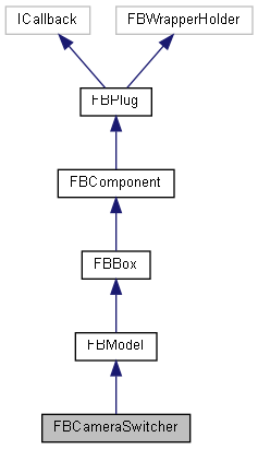

Camera switcher. More...
#include <fbcamera.h>
Public Member Functions | |
| FBCameraSwitcher () | |
| Constructor. More... | |
| bool | PlotToCamera (FBCamera *pCamera) |
| Plot the Camera Switcher animation onto a destination camera. More... | |
Public Member Functions inherited from FBModel | |
