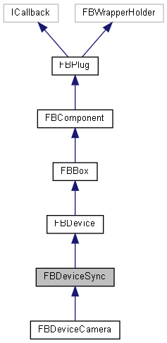

Inheritance diagram for FBDeviceSync:

Detailed Description
Sync'ed device class.
Base class for devices that are streaming data that will be accessed based upon a sync'ed stream (such as a genlock).
Definition at line 89 of file fbtracker.h.

int  pPacketCount
virtual
Print to screen input/output notification info.
Parameters
pInfoDevice sync packet.
pPacketCountDevice notification info.
Member Data Documentation
◆ DebugInfo
FBPropertyBool DebugInfo
Property: Debugging Info?
Definition at line 190 of file fbtracker.h.
◆ PacketBufferSize
FBPropertyInt PacketBufferSize
Property: Packet buffer size(default=100).
Definition at line 188 of file fbtracker.h.
◆ SyncDelay
FBPropertyInt SyncDelay
Property: Synchronization delay (in sync count units).
Definition at line 189 of file fbtracker.h.
