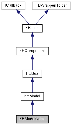

Cube model class. More...
#include <fbmodel.h>
Public Member Functions | |
| FBModelCube (const char *pName, HIObject pObject=NULL) | |
| Constructor. More... | |
Public Member Functions inherited from FBModel | |

| FBModelCube | ( | const char * | pName, |
| HIObject | pObject = NULL |
Constructor.
| pName | Name of cube. |
| pObject | For internal use only(default=NULL). |
