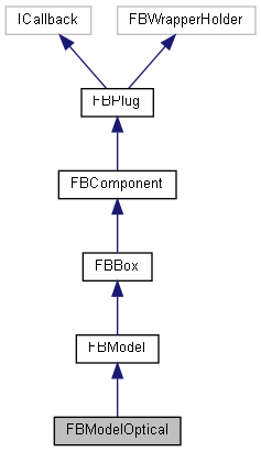

Optical model class. More...
#include <fboptical.h>
Public Member Functions | |
| FBModelOptical (const char *pName, HIObject pObject=NULL) | |

Public Member Functions inherited from FBModel | |

Public Member Functions inherited from FBBox | |

Public Member Functions inherited from FBComponent | |
