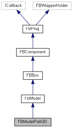

Path 3D model class. More...
#include <fbmodelpath3d.h>
