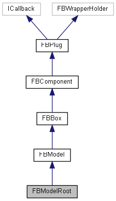

Root object class. More...
#include <fbmodel.h>
Public Member Functions | |
| FBModelRoot (const char *pName, HIObject pObject=NULL) | |
| Constructor. More... | |
Public Member Functions inherited from FBModel | |
| FBModel (const char *pName, HIObject pObject=NULL) | |
