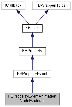

PropertyEvent: Event when a custom tangent that needs to be evaluated. More...
#include <fbdata.h>
virtual |
Add/Remove a callback.
| pOwner | Callback owner. |
| pHandler | Callback handler. |
Reimplemented from FBPropertyEvent.
virtual |
