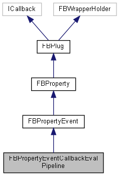

PropertyEvent: Callback at evaluation pipeline (for kFBGlobalEvalCallbackBeforeDAG, kFBGlobalEvalCallbackAfterDAG, kFBGlobalEvalCallbackAfterDeform, kFBGlobalEvalCallbackBeforePlottingFrame and kFBGlobalEvalCallbackAfterPlottingFrame) More...
#include <fbevaluatemanager.h>
Definition at line 104 of file fbevaluatemanager.h.
virtual |
Add/Remove a callback.
| pOwner | Callback owner. |
| pHandler | Callback handler. |
Reimplemented from FBPropertyEvent.
virtual |
