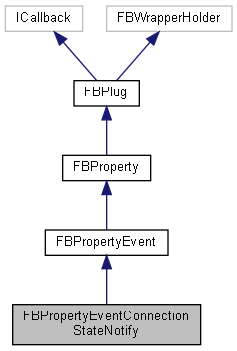

PropertyEvent: Global ConnectionStateNotify event. More...
#include <fbproperties.h>
Public Member Functions | |
