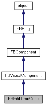

#include <pyfbsdk.h>
Public Member Functions | |
FBEditTimeCode () | |
Constructor. More... | |
FBVisualComponent () | |
