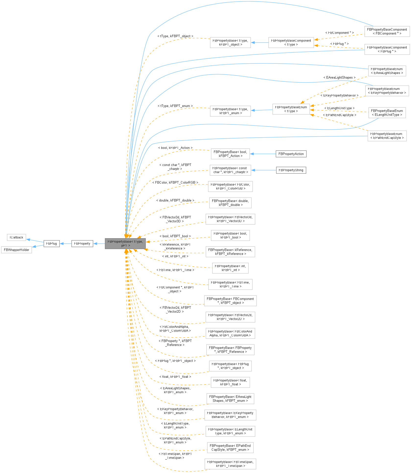

Definition at line 622 of file fbproperties.h.
| typedef tType ValueType |
Property Value Type.
Definition at line 632 of file fbproperties.h.
inline |
Constructor.
Definition at line 635 of file fbproperties.h.
inline |
inline |
Destructor.
Definition at line 643 of file fbproperties.h.
inlineoverridevirtual |
Get value.
| pValue | Value to fill with current object value. |
Reimplemented from FBProperty.
Definition at line 724 of file fbproperties.h.
References FBProperty::GetData().
Get the property's type.
Definition at line 688 of file fbproperties.h.
inline |
Get the value of the internal property.
Definition at line 704 of file fbproperties.h.
inline |
Initialization function.
| pParent | Parent object. |
| pName | Name of base enum. |
| pGet | Get function (default=NULL). |
| pSet | Set function (default=NULL). |
Definition at line 654 of file fbproperties.h.
Is this class read-only? If there is an existing set function, this class is read/write, otherwise it is read-only.
Definition at line 719 of file fbproperties.h.
References FBProperty::IsReadOnly().
inline |
Overloaded cast to tType operator.
Get the value of the current object using Get fuction.
Definition at line 683 of file fbproperties.h.
inline |
Overloaded = operator.
Set the value of the current object with another property value of the same type.
| pProperty | Property to use to set the value. |
Definition at line 676 of file fbproperties.h.
References FBPropertyBase< tType, pPT >::operator=().
Referenced by FBPropertyBase< tType, pPT >::operator=().
inline |
Set the value of the current object using the Set function.
| pValue | Value to set for object. |
Definition at line 668 of file fbproperties.h.
Referenced by FBPropertyBaseComponent< tType >::FBPropertyBaseComponent(), and FBPropertyBaseComponent< tType >::operator=().
Set value.
| pData | Integer to use to set. |
Definition at line 743 of file fbproperties.h.
References FBProperty::SetData().
inlinevirtual |
Set the value of the internal property.
| pValue | Value to set to internal property. |
Reimplemented in FBPropertyString.
Definition at line 693 of file fbproperties.h.
