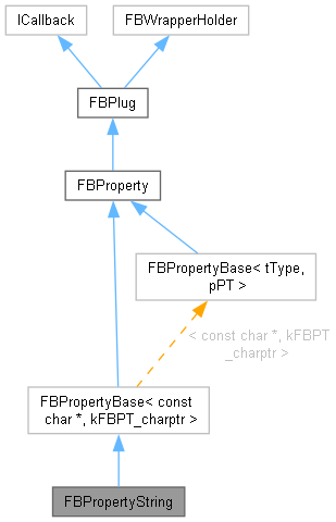

Property class: const char * (String). More...
#include <fbproperties.h>
