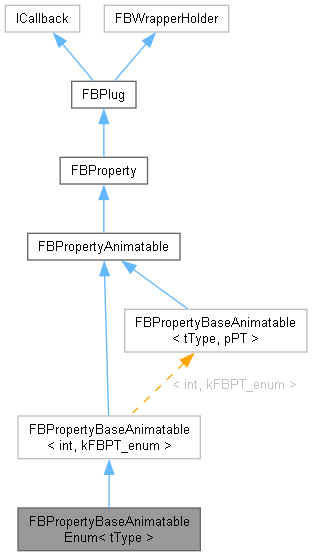

template<class tType>
class FBPropertyBaseAnimatableEnum< tType >
Definition at line 1789 of file fbproperties.h.
