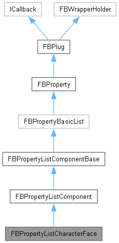

Inheritance diagram for FBPropertyListCharacterFace:
