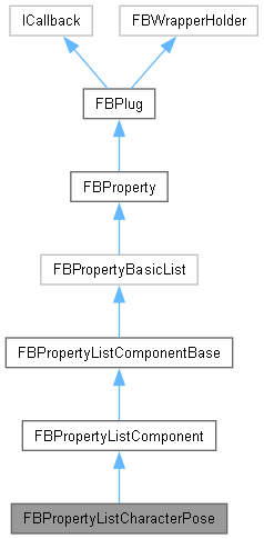

FBPropertyListCharacterPose Class Reference
PropertyList: CharacterPose. More...
#include <fbcharacterpose.h>
Inheritance diagram for FBPropertyListCharacterPose:
