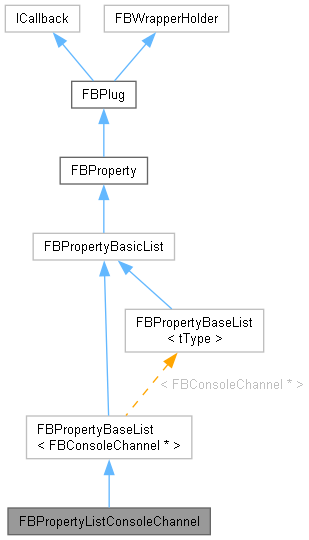

Inheritance diagram for FBPropertyListConsoleChannel:
