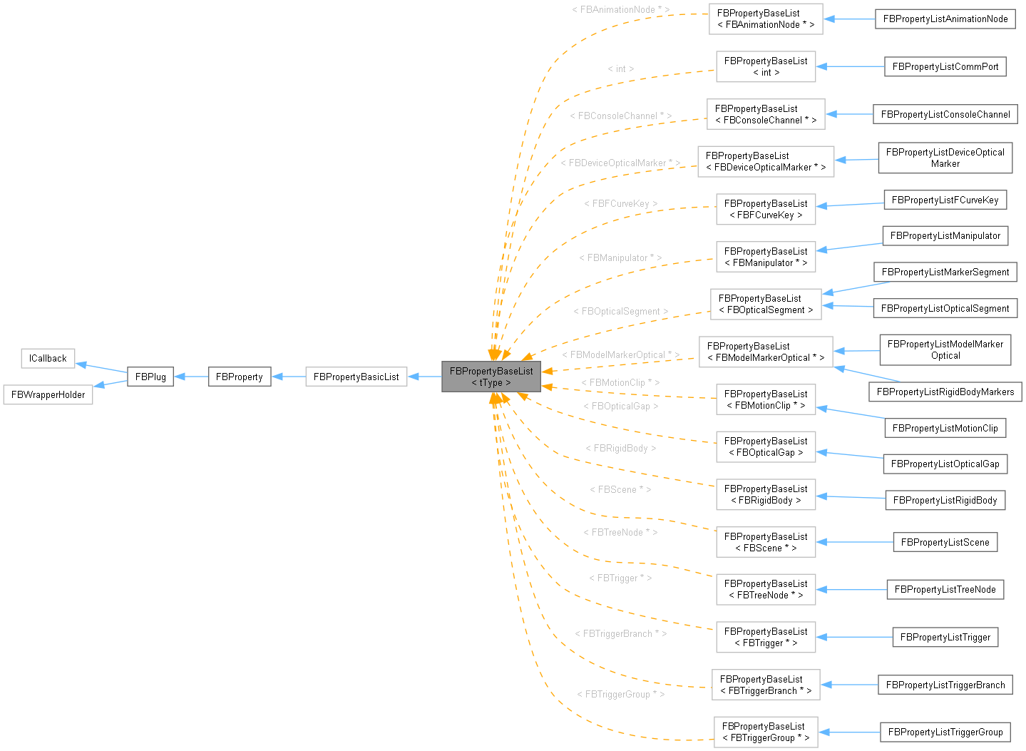

template<class tType>
class FBPropertyBaseList< tType >
Definition at line 892 of file fbproperties.h.
