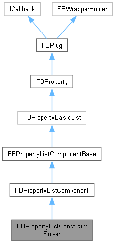

FBPropertyListConstraintSolver Class Reference
PropertyList: Constraint solver More...
#include <fbconstraint.h>
Inheritance diagram for FBPropertyListConstraintSolver:
Public Member Functions
FBConstraintoperator[] (int pIndex)
 Get the model template at pIndex.
