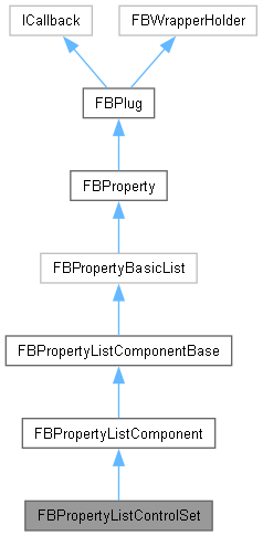

PropertyList: MarkerSet. More...
#include <fbcharacter.h>
Public Member Functions | |
| FBControlSet * | operator[] (int pIndex) |
| Get the marker set at pIndex. | |
Public Member Functions inherited from FBPropertyListComponent | |
| virtual FBComponent * | GetAt (int pIndex) |
| Get the Component at pIndex. | |
These classes are under development and may change dramatically between versions.
Definition at line 1883 of file fbcharacter.h.
| FBControlSet * operator[] | ( | int | pIndex | ) |
| pIndex | Index of marker set to get a handle on. |
