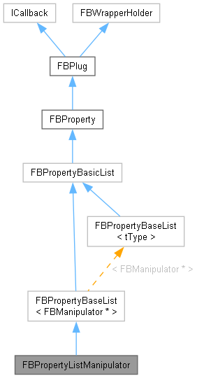

PropertyList: Manipulator.
Definition at line 242 of file fbmanipulator.h.
