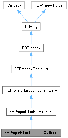

PropertyList: Texture
Definition at line 419 of file fbrenderer.h.
