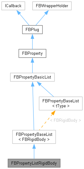

Inheritance diagram for FBPropertyListRigidBody:
