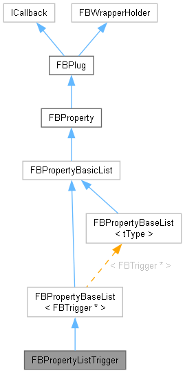

Inheritance diagram for FBPropertyListTrigger:
