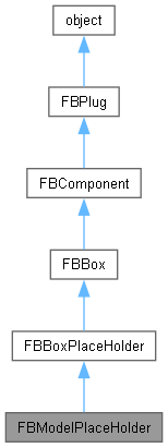

Wrapper around a specific instance of a FBModel object. More...
#include <pyfbsdk.h>
Public Member Functions | |
FBModelPlaceHolder () | |
Constructor. | |
FBBoxPlaceHolder () | |
Constructor. | |
FBBox (str pName) | |
Constructor. | |
This class is mainly used with a constraint relation to have multiple boxes that are a representation of the same underlying model. Instantiation of FBModelPlaceHolder should be left to the the system.
