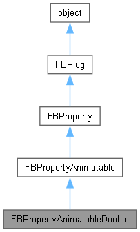

#include <pyfbsdk.h>
Public Attributes | |
| float | Data |
Public Attributes inherited from FBPropertyAnimatable | |
| object | Data |
| Read Write Property: The property data value. Type of this depends on the subclass of FBPropertyAnimatable (ex: in a FBPropertyAnimatableInt, Data is of type int). | |
Public Attributes inherited from FBProperty | |
| str | Name |
| Read Property: The property's name. | |
| object | Data |
| Read Write Property: The property data value. Type of this depends on the subclass of FBProperty (ex: in a FBPropertyInt, Data is of type int). | |
Public Attributes inherited from FBPlug | |
| str | ClassGroupName |
| ClassGroupName of the object. | |
| int | TypeInfo |
| TypeInfo. | |
Additional Inherited Members | |
