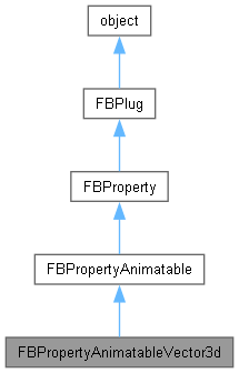

Inheritance diagram for FBPropertyAnimatableVector3d:
