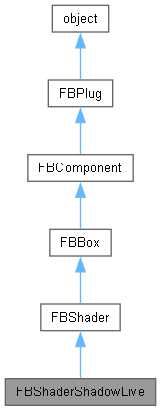

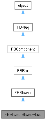

Inheritance diagram for FBShaderShadowLive:
