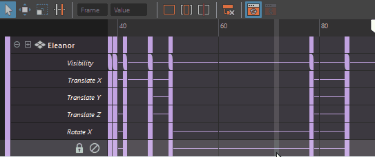

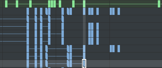

- Select keys
- Press
Q or use the
Select Tool
on the
Dope Sheet Toolbar to select a key in the View area.
Shift-click to add non-consecutive key to the selection and drag to select a group of keys.

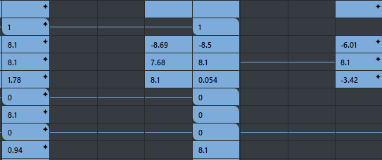

- Edit key values
- Double-click a key in the view area to enter a new value.
To update more than one key value with the same value
- Shift-select multiple
Dope Sheet Editor keys.
- Shift+ double-click one of the selected keys and enter a value to change them all at once.

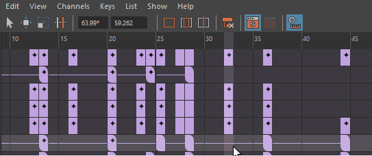

- Move the key selection
- With one or more keys selected, middle-drag left or right to reposition the keys. Drag to move a selected key while the mouse is on the key, or middle-drag to move a selected key while the mouse is off the key.
- Click
Time Snap
on the
Dope Sheet Toolbar if you want to make sure that keys are forced to snap only to whole frames.
- You can also press
W or click the Move Tool
on the
Dope Sheet Toolbar.
- Double-click the Move Tool
icon to open the
Move Key Settings, where you can select the behavior of keys when you move them:

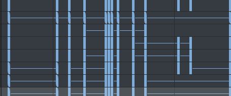

- Scale keys
- Press
R or click the Scale Tool
icon on the
Dope Sheet Toolbar and drag across a group of keys to select them. A white scaling box surrounds the keys that you can use to stretch or shrink the selection.

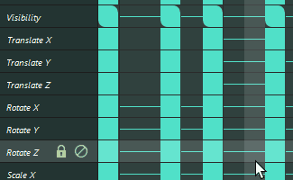

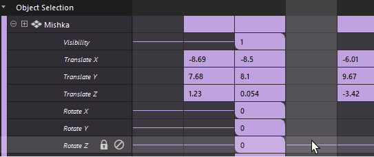

- Mute keys or channels
- You can mute animation keys or channels to temporarily "turn off" the effect of the key or channel. Muting lets you focus on another part of the animation or isolate the animation to fine-tune it. Sometimes you can improve performance by excluding the unnecessary animation from playback using Mute.
- Muted channels show as striped in the
Dope Sheet view area.
| Option
Behavior
| Mute a channel
Click the Mute icon
next to the corresponding channel in the
Dope Sheet outliner to turn off any effect that the Channel has on the scene.
See
Mute channels.
| Mute a key
Right-click the key and choose
Keys >
Mute Key to stop the key from contributing to the animation on the channel.
See
Mute keys.
- Lock channels
- You can also lock a channel to stop it from being edited. Unlike Muting, the channel is still part of the animation, but cannot be edited. Click the Lock icon
next to the corresponding channel to lock it.
- The locked channel is grayed out.
Note: You can't lock single keys.

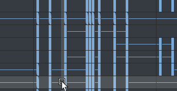

To use the
Dope Sheet
Transformation Tools
Select keys manipulator
- Select
. The
Dope Sheet Editor opens.
- Select the objects you want to modify in the
Viewport or
Outliner.
The selected objects and their keyframes appear in the
Dope Sheet.
- In the
Dope Sheet Editor, click
Edit
Transformation Tools >
Select Keys (

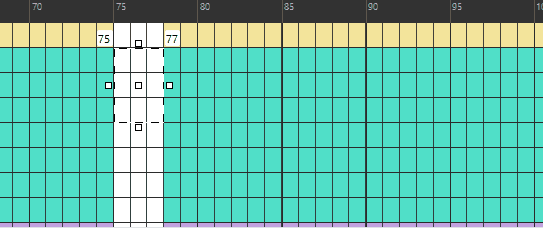

- In the
Dope Sheet View Area, drag a region around the keys you want to manipulate.
The
Dope Sheet
Select keys manipulator appears around the region you selected.
Note: The
Dope Sheet
Select keys manipulator appears as a dotted outline with a point on each side and at each corner. Frame numbers appear at both side to indicate your position in the animation. Use the points to control the Manipulator, the cursor becomes a "+" plus to let you know you can resize the selection.
- To manipulate the selected region of time and keys with the
Dope Sheet Manipulator, do the following:
- Modify the key selection
- To expand the selection drag the point in on the top, bottom, or side of the selected region.
- To move the key selection
- Shift-drag the point in the center of the selected region to a new position.
- To copy-paste a key selection
- Drag the manipulator where you want to paste the copied keys and press
Ctrl +
C. Press
Ctrl +
V and the selection is pasted at the left edge of the manipulator.
Important: If keys are present at the insertion point, they are moved forward
to accommodate the insertion of the copied range of keys.
- To cut the key selection
- To cut a selection and move it in the View area, press
Ctrl +
X to
cut the keys defined by the manipulator, then drag it with the center dot to where you want to paste the keys. Press
Ctrl +
Select keys manipulator.
to accommodate the insertion of the cut range of keys.
- To scale the key selection
- Shift-drag the right edge of the selection manipulator.
