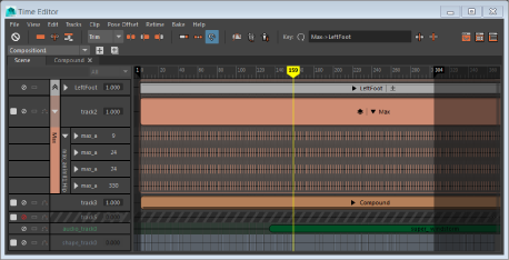

What is the Time Editor?
The Time Editor is an animation non-linear editor that lets you edit and manage dozens of real-world rigs/characters in an easy-to-use workflow. The Time Editor gives you high-level control over animation letting you layer and mix sequences in a nonlinear, non-destructive way. It helps you reuse and fine-tune animation you've created with keyframes, expressions, and constraints.

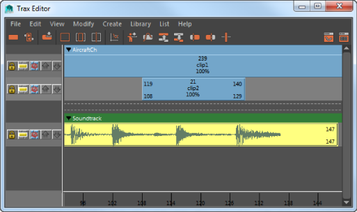

What is the Trax Editor?
The Trax Editor is a high-level animation tool that lets you select and control characters and their animation clips, layer and blend animation sequences, synchronize your animation and audio clips, and drag-and-drop animation clips between mapped characters. See Mapping animation between characters in the Character Setup guide. You can work with any type of animation in the Trax Editor—except motion path animation.
For example, suppose you keyframed a character’s walk and you now want to turn it into a walk cycle. You can create a clip for the keyframe animation sequence, scale and trim the clip to get it to be the right length and to have similar start and end poses, and then cycle the clip to create a proper walk cycle. If you wanted to change the walk cycle’s pace or rhythm, you can then create a time warp curve for the clip, or if you wanted to turn the walk into a march, you can manipulate the character and key into the clip directly. You can do all this to the character’s walk sequence without destroying the original keyframe animation because you are working with clips.

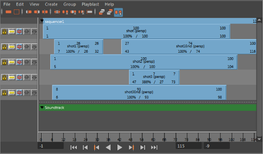

What is the Camera Sequencer?
The Camera Sequencer is a tool that lets you create, re-arrange, and manipulate camera shots of your scene. Each shot defines which camera is active at any particular time, and for how long.
By adjusting the placement and timing of camera shots, you can effectively manage the ‘filming’ of the animation in the scene. When you finish manipulating camera shots in the Camera Sequencer, you can playblast the sequence into a rendered movie clip.

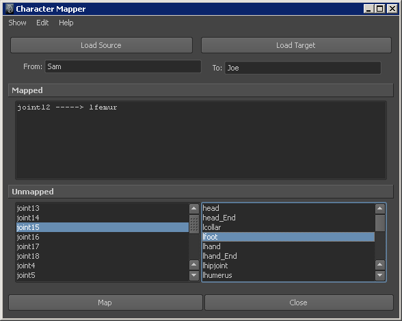

What is the Character Mapper?
With the Character Mapper window you can create a correspondence between a source and target character’s nodes or attributes so that you can import and export or copy and paste animation clips between mapped characters in the Trax Editor.

Before you can drag and drop or copy and paste clips from one character to another, the characters must first be mapped. See Mapping animation between charactersin the Character Setup guide.
