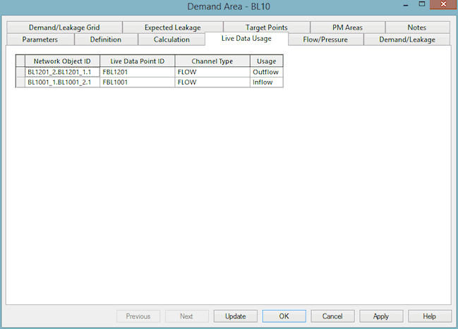

The Demand Area Live Data Usage Page is used to view the linked Live Data in the Demand Area. The Live Data Usage Grid shows the Live Data ID, the network object that the Live Data is linked to, the type of Live Data and how the Live Data is used in the demand calculation.
The grid is only populated when the relevant live data configuration file is open, along with the network and control.
The live data Usage may be one of six options:
*The calculation assumes that the connectivity of the bounding links is in the positive direction of flow. i.e. a bounding link with reversed connectivity will cause an Inflow to be used as an Outflow in the Demand Calculation and vice versa.
Live Data Point IDs are generated from Live Data Point, Live Data Feed, or Live Data Composite Feed. Duplicate IDs are shown once.
